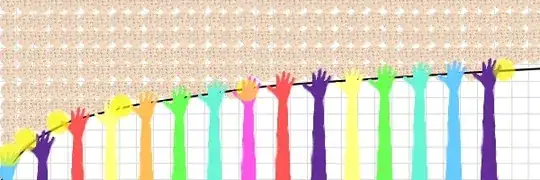

Let's say I give you a cookie, and then I give you second cookie. How much more cookie do you have? "One cookie, clearly."
What if I give you a third cookie? How much more cookie do you have? "Again, one..."
Please humor me once more: Is cookie three as much "cookie" as cookie two?
What if we add a fourth? If we try to feel "cookie" amount logarithmically, we can see a parallel with what we intuitively know as marginal utility. A young child sees all quantities in this relative fashion. (See the number line above.) A two person party feels like a huge leap from a party of one, but the jump from five to six just doesn't impress.
Even we slip up if we jump up a few magnitudes: \$1 to \$100? Woah buddy! \$1,000,000 to \$1,000,100? Psh.
So... how do you go about explaining logarithms to a child? With cookies of course! ;D

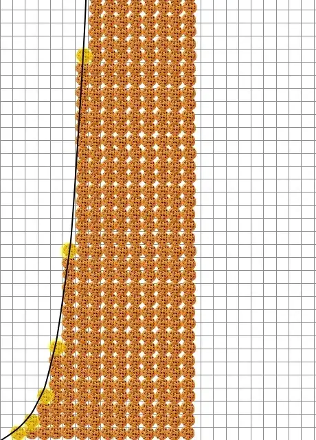

Totally Sweet Explanation of Logarithms
Let's say we have a baker, who makes cookies! This baker has a "powerful" oven. When the heat is low and he puts in one cookie, after one minute the cookie bursts into two cookies! Another minute later, each of those cookies burst into two again. With every minute, it happens again and again! So if the baker leaves his oven on for a long time, his whole bakery will fill with cookies! The baker can also set the oven to high. When he does this, each cookie in the oven turns to three after each minute. The baker uses those tools and to make numbers grow faster. Just like the baker we have tools to make numbers grow very fast. The fastest is called the "power" and it works just like the oven, except with more notches Instead of two or three cookies imagine five cookies popping up every time from every cookie! We can also put in more cookies at the beginning meaning even more at the end! If we keep using "power" our number gets bigger and bigger going, upwards until we can't even see how high it goes:
Now that baker... he loves cookies, especially his first. His second too, but not as much as the first. As he gets to his fifth he feels full, but man, those cookies are still pretty yummy, so he might have one more, but then after the hundredth cookie, the next cookie isn't that special, its almost the same as the ten before. Logarithms look the way the baker feels about eating that next cookie. There's a big change in the beginning because the having the first after the second is really good, as but then the 101th is barely better than the 100th.
After a while, the cookies aren't so much more exciting than the ones before. How far the hand reaches changes less and less. The cookies keep on growing more and more and more, but after a while we can't get any happier or excited than we already are. So they're a special type of opposites. We call this opposite of power/exponent in math a logarithm.
Now let's say the baker comes to our house and bakes cookies for us. After 10 minutes the whole house fills up with cookies! The baker can't remember what happened, so we investigate. The baker had set the oven to a temperature, put some cookies in, and waited 10 minutes. Maybe he set the temperature too high. We go check the oven and see it set on low. That means he must have put in too many cookies! But how many cookies? Since we're trying to think backwards from the really fast growing of the cookies (in the power oven), we need to use the opposite way of thinking... this opposite is called a logarithm. If we count up all the cookies and use that number with the temperature and put it into the calculator, we can use a logarithm button to find out how many cookies the baker started with. Why do we need a calculator? Because sometimes there are just too many cookies. ;)

11Best graphs ever. Needs a picture of the cookie monster in there somewhere. Also, it should be noted that in the real world, not only does the marginal gain from more cookies after you've had a lot get less and less, but it starts to get negative (no-one like being force-fed cookies!). You could use that to teach the kids about idealised models as well! – naught101 Apr 09 '12 at 01:49
This is wrong. The log does not tell you how many cookies you start with! – user21820 Jun 22 '15 at 12:29
This psychophysical phenomenon is called Fechner’s law (closely related to Weber’s law), and it applies to perception in general, from all five senses. – gen-ℤ ready to perish Oct 05 '17 at 04:46

You can try with a number line but I think a graph would work better as a number line would not only quickly run out of numbers, but not show the relationship between the base and value it is being applied to. Use Log 2 and Log 10 first!

Repeated doubling is a good way to get big numbers fast. Start with 1 and double it a few times: you get 1, 2, 4, 8, 16, ... (You could tell them about bacteria dividing, if you want to motivate them to wash their hands; or use rabbits multiplying, but that maybe requires having another, even more challenging talk.)
How many times do you have to double 1 to get 32? 5 times.
How many times do you have to double 1 to get 128? 7 times.
How many times do you have to double 1 to get 50? Well, 5 is not enough, but 6 is too many... we must be looking for a number between 5 and 6...
