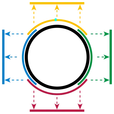

The circle is a manifold and therefore we have to check the dimension's definition of a manifold:
A manifold $M$ has dimension $n$, when you can find for each point $p \in M$ a neighborhood $U$ of $p$ such that there is an open $V \subseteq \mathbb R^n$ and a homeomorphism $f: U \rightarrow V$
An homeomorphism is a bijective and continuous function whose inverse is also continuous. Now take the circle. You can divide it in four segments:
File:Circle with overlapping manifold charts.svg by User:KSmrq and User:Pbroks13 licensed under CC-BY-SA 3.0
You see, that each segment can be continuously maped to an interval (i.e. a set of $\mathbb R^1$). Thus the dimension of the manifold is 1. See also this section.
Note: You only need one information to identify a point of the circle uniquely. The angle $\phi$ in polar coordination. From this you also see, that the dimension of the circle must be one.
