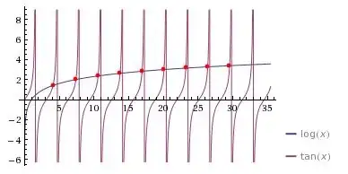

Lets take $f(x)=\ln{x}$ and $g(x)=\tan{x}$
When $f(x)=g(x)$ that is $\ln{x}=\tan{x}$, we see that the graph is like:
ln(x) = tan(x)
Hence we see that there are infinitely many solutions to $x$ but the two graphs do not coincide (like while solving "$x=x$"!)
The solutions as given by WolframAlpha were like :
Sol. to ln(x)=tan(x)
So i decided to use Newton's method to solve this but due to having infinitely many solutions, all solutions given by that method were close to the approximations given by WolframAlpha but were not as accurate.
$x_{n+1} = x_{n} - \dfrac{\ln{x_{n}}-\tan{x_{n}}}{{\dfrac{1}{x_{n}}}-\sec^2{x_{n}}}$
giving us x = 4.02 , 7.31 , ... (and hence not correct)
So is there any other way to solve these system of equations? Maybe using Lambert-W or maybe it does have some simple solution which I'm missing?
