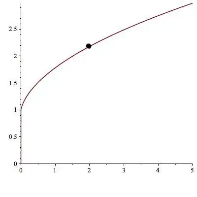

Related will be $$ g(u) = \sqrt{u+\sqrt{2u+\sqrt{4u+\sqrt{8u+\dots}}}} $$ so that $f(x) = g(2^x)$. Graphically, $g$ looks like this, g(x)
with $g(2) = 2.17968$ marked. Numerically we see $$ \lim_{u \to 0^+} g(u) = 1 $$ $g(u)$ is complex (non-real) for $u<0$.
$g$ satisfies $g(u)^2=u+g(2u)$, which lets us compute an asymptotic expansion for $u \to \infty$ $$ g(u) = u^{1/2} + \frac{1}{\sqrt{2}} +\left(\frac{1}{2\sqrt{2}}-\frac{1}{4}\right)u^{-1/2} +\left(\frac{1}{8\sqrt{2}}-\frac{1}{8}\right)u^{-1} +\left(\frac{9}{32\sqrt{2}}-\frac{3}{16}\right)u^{-3/2} +O(u^{-2}) $$
