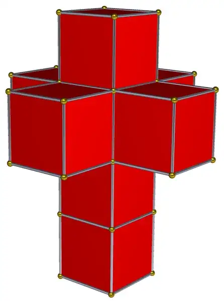

Now let's look at the net of a tesseract:
net of a tesseract
Again, obviously on the surface cubes everything behaves just like in normal space. Also the squares where those cubes meet are quite normal. But at the edges, you'd get the same strange behaviour the cube-dwelling flatlander would observe at the cube corners, except that now we have complete lines of those. And of course on the corners, three such lines meet, and the behaviour gets even stranger. So we have a lattice of lines with strange behaviour.
