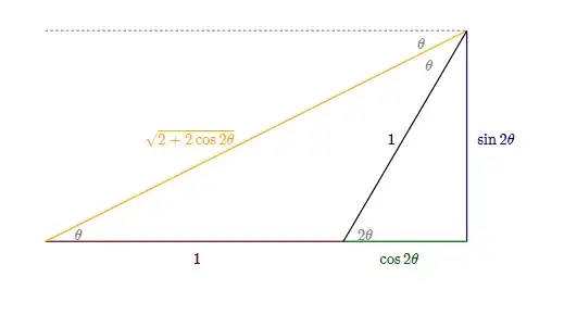

Or, for the $\cos2\theta$ formula and $0<\theta<\pi/2$, consider the diagram:
We have $$ \cos\theta ={ {1+\cos2\theta}\over\sqrt{2+2\cos 2\theta}}; $$ whence $$ \cos\theta={ {\sqrt{1+1\cos2 \theta}}\over{\sqrt{2} }} $$ or, $$ 2\cos^2\theta= 1+1\cos2\theta $$ From this, we have $$ 2-2\sin^2\theta=1+\cos2\theta, $$ or $$ \cos2\theta =1-2\sin^2\theta. $$
(Having this in hand, we could also use the diagram to derive the formula for $\sin2\theta$.)
