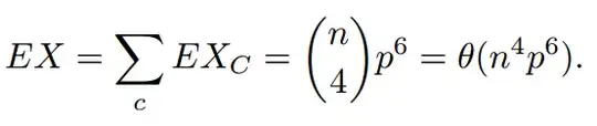

Is it a valid to say $$ {n \choose k} = \Theta \left( n^k \right) $$ for any $n$ and $k$? If so, how to prove it?
Note: $k$ is not a function of $n$.
Note: Observed it here (page 5): http://www.cs.berkeley.edu/~sinclair/cs271/n6.pdf
