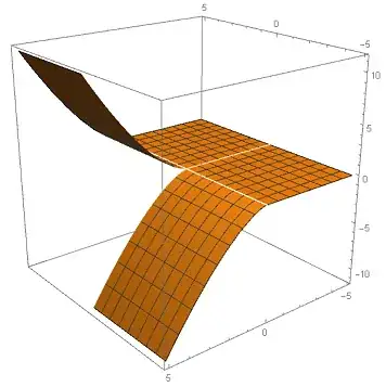

Your textbook is not just being pedantic, however. If one wishes to study multivariable calculus, the definition of differentiability which requires taking limits in all directions is much more robust, compared to one-sided limits: the main problem being that in one dimension, given a boundary point, there is clearly a "left" and a "right", and each occupies "half" the available directions. This is no longer the case for domains in higher dimensions. Consider the domain
$$ \Omega = \{ y \leq \sqrt{|x|} \} \subsetneq \mathbb{R}^2$$
$\hspace{5cm}$enter image description here
A particular boundary point of $\Omega$ is the origin. However, from the origin, almost all directions point to inside $\Omega$ (the only one that doesn't is the one that points straight up, in the positive $y$ direction). So the total derivative cannot be defined at the origin if a function $f$ is only defined on $\Omega$. But if you try to loosen the definitions and allow to consider only those "defined" directional derivatives, they may not patch together nicely at all. (A canonical example is the function $$f(x,y) = \begin{cases} 0 & y \leq 0 \\ \text{sgn}(x) y^{3/2} & y > 0\end{cases}$$ where $\text{sgn}$ return $+1$ if $x > 0$, $-1$ if $x < 0$, and $0$ if $x = 0$. Its graph looks like what happens when you tear a piece of paper.)
$\hspace{4cm}$enter image description here
