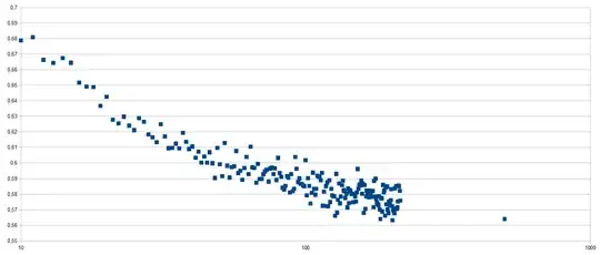

I thought Hardy-Littlewood might come into it. Here is some numerical data following Erics great answer: x-axis: N ; y-axis: Geometric mean of the first 10000 prime gaps following $10^N$ divided by $\ln 10^N$
x-axis: N
y-axis: Geometric mean of the first 10000 prime gaps following $10^N$ divided by $\ln 10^N$.
$e^{-\gamma} \approx 0.56146$.
    This is fantastic. I was wondering why my numerical data seemed a little off - I did not take $N$ to be anywhere near large enough! – Eric Naslund May 17 '15 at 11:03
    It does converge rather slow(ly?). The number of gaps for a given size has to be large as well. Looking at the graph, 10000 gaps is not enough to get a very accurate result, but the trend is clearly visible. – Michael Stocker May 18 '15 at 12:14
