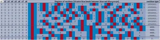

Unfortunately, not every necklace appears eight times. Some necklaces appear only four times, some twice, and one necklace would appear exactly once. Here’s a picture of just a few solutions and (straightened-out) necklaces, grouped by matching necklaces.
So here’s an idea: carefully duplicate some of the solutions just as necessary so that you have a list where all the necklaces do appear exactly eight times.
If a necklace appears only four times, list each solution with that necklace twice. If a necklace appears just twice, list each solution for that necklace four times, and include the solution that gives one necklace ($x_i=2$) eight times instead of once.
