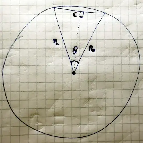

The short approach.
From basic trigonometric identity $$\sin \frac {\theta}{2} = \frac {c}{2r}~~~~(1)$$ where $c$ is chord length, we know that when given angle $x$ is very small, i.e. $x \to 0$ then $\sin x \approx x$, (this can be seen expanding $\sin x $ as Maclaurin Series about $0$). So from (1) and with small angle assumption we can extrapolate, that: $$ c = r~\theta ~~~~(2)$$
Substituting into (2) elementary angle, instead,- gives elementary chord expression:
$$\text{d}c = r~\text{d}\theta~~~~(3)$$
Multiplying both sides by $\text{d}r$, we get elementary area :
$$\text{d}c~\text{d}r = r~\text{d}\theta ~\text{d}r~~~~(4)$$
Double integration of (4) equation gives circle area:
$$ \begin{align} A_{circle} &= \int _0^R \int_0^{2\pi} r~ \text{d}\theta ~\text{d}r\\ &=\int _0^R r~ \theta \Big|_{0}^{2\pi} ~\text{d}r \\ &=\int _0^R 2\pi r ~\text{d}r\\ &=2\pi \int _0^R r ~\text{d}r\\ &=2\pi \frac {r^2}{2} \Big|_{0}^{R}\\ &=\pi R^2 \end{align} $$
