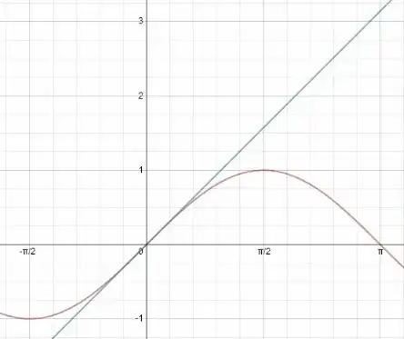

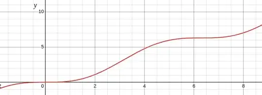

Define the function $f(x)=x-\sin x.$ enter image description here Image with the courtesy of Alphonsio
Observe that $f(0)=0$ and $f'(x)=1-\cos x \geq 0$. The derivative is equal to $0$ only at isolated points, so the function increases in the interval $[0, \infty)$. That is, for all $x>0$ we have $f(x)>f(0)=0$. Thus $x>\sin x$ for all $x>0$.
