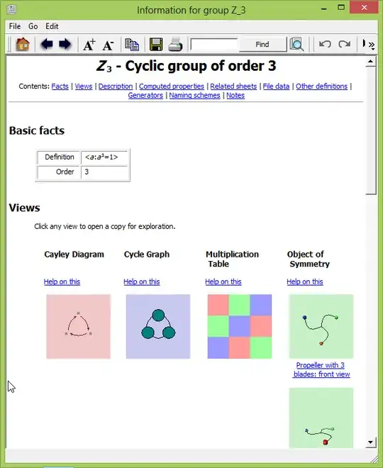

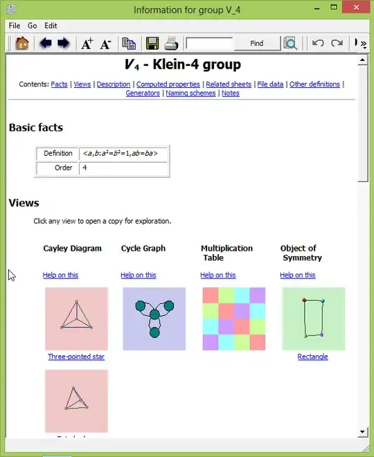

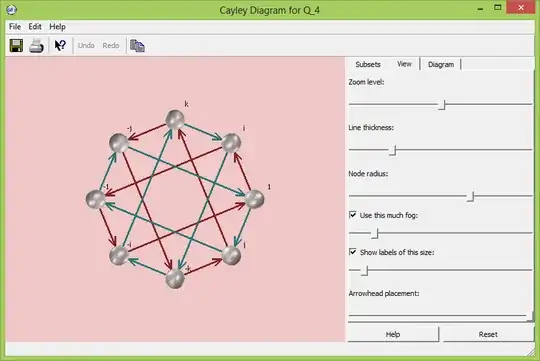

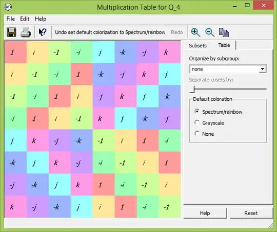

10
You might find interesting a computer app called Group Explorer.
The app provides visualizations of 59 groups. Additional groups are available as separate downloads.
Some screenshots:
