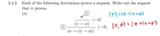

Trying to learn sequent calculus and so I am trying to work thru some examples to get a better grip/understanding but the following question is not answered at the back of the book. I wrote my guess in the blue writing in the attached picture, however I am unsure of my answer because phi appears in the consequent under the first line. So I am wondering if it should look like my second guess which is written in red. The book I took this from is Mathematical Logic, by Hodges. Hope somebody can explain what is correct and why, please!!!

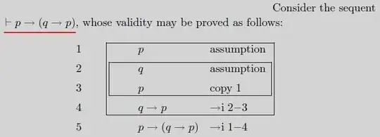

It is meant to prove the sequent $\vdash\phi\rightarrow (\psi\rightarrow\phi)$, but the derivation is not complete. The first $(\rightarrow I)$ needs the assumption $\psi$ (and repeating the assumption $\phi$):
From "Logic in computer science" (Huth & Ryan) page 20:
Logic in computer science, Huth & Ryan
Also note that your derivation is in Natural Deduction and it's different from Sequent Calculus (since you said you are trying to learn Sequent Calculus)

    Mauro is correct, another way to view the suddenly appearing premise is thru the addition rule combined with viewing the implication as a disjuction (material implication). – skyfire Apr 25 '15 at 14:18
  • Albeit I initally agreed with you, which was why I was so confused by the book posing the question in that way. – skyfire Apr 25 '15 at 14:21
  • @skyfire - Brilliant ! We have : $\phi \vdash \phi \vdash \lnot \psi \lor \phi$ by $\lor$-introduction ... – Mauro ALLEGRANZA Apr 25 '15 at 15:00
    @skyfire - but note that both rules $\to$-intro and $\lor$-intro are intuitionistically valid, while the equivalence between $p \to q$ and $\lnot p \lor q$ is not ... – Mauro ALLEGRANZA Apr 25 '15 at 15:11
  • We can always introduce new rules as shorthands for a combination of "basic" rules. The reason I said it is not complete was that if we want to use only the basic rules of natural deduction, then we need a longer derivation. For example, the derivation of $p\lor\neg p$ in Natural Deduction is not very short, but you may just derive it in one step and use it in derivations as a "new rule", because you know it is provable. But I believe in these cases it is better to use a symbol different from the basic rule names. For example use $Abr$ (abbreviation). @MauroALLEGRANZA – LoMaPh Apr 25 '15 at 20:01
Neither.
The sequent proved is :
$\vdash (\phi \to (\psi \to \phi))$.
It is the last formula and the only assumption of the derivation : $\phi$, has been discharged (it is crossed with the "dandah").
The derivation is correct; see the discussion in :
or see the relevant parts quoted into this post.
The approach followed by Chiswell & Hodeges into this example simply amounts to :
we can discharge any assumptions, also assumptions not "declared" as such in the derivation.
The intuition behind it is quite simple : let's start assuming $\phi$, and derive $\phi$.
Having preformed this obviuos derivation of $\phi$ from some assumptions, it is harmless to assert that we have derived it from "those" assumption plus some extra-one.
Conclusion : we can always add "unnecessary" assumptions in a derivation.
