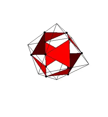

Start with an octahedron $\mathcal O$ with edges of length $1$. You can color its faces inblack and white in such a way that no two faces of the same color share an edge, and then you can orient each edge of $\mathcal O$ so that when you move along it, with your head pointing towards the outside of $\mathcal O$, you have white on your left. Now pick a number $\theta\in[0,1]$ and on each edge of the octahedron mark the point which is at distance $\theta$ from the starting vertex of that edge (according tothe orientations we fixed)
If $\theta\in(0,1)$, then this construction gives us 12 points, one one each edge. If you think about this a little bit you'll see that for some value of $\theta$ these twelve points are the vertices of a dodecahedron: this is a simple consequence of the intermediate value theorem from calculus. One can explicitely compute this, with some work, and it turns out that we need $\theta$ to be the inverse of the golden ratio.
The following Mathematica code gives an interative thingie to see this construction:
vertex = Flatten[

This produces images such as
but the interesting thing is really the interactivity which allows you to play with it and see how the picture changes when you change $\theta$.
Now of course this does not answer your question, because I constructed a dodecahedron from an octahedron, and you wanted an icosahedron from a cube! But one can dualize this constructing, taking advantage of the fact that the dual of a cube is an octahedron, and the dual of an icosahedron is a dodecahedron. I'll leave all that fun to you.
