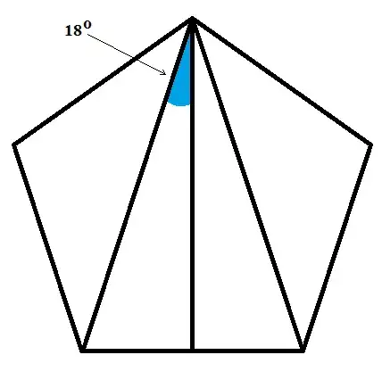

This may make a nice challenge for you. Use a regular pentagon to find the $\sin 18^\circ$.

  • i don't know what to do, do i have to find the length of side of the triangle with respect to side of a pentagon – R K Apr 20 '15 at 14:25
  • Exactly. The easy part is finding half of the side; the hard part is finding the diagonal relative to a side. Try Googling "pentagon golden ratio" for ideas. see a related post http://math.stackexchange.com/questions/763128/exact-value-for-cos-36%C2%B0 – John Joy Apr 20 '15 at 14:32

I do not know if you know multiple angle trig formulas.
Let $ A = 18 ^\circ. $ In a right angled triangle if acute angles are $ 2A= 36 ^\circ, \,3A= 54^\circ$,
$ \sin 2 A = \cos 3A $
$ 2 \sin A \cos A = 4 \cos^3 A -3 \cos A $
simplifying and solving for $ \sin A $ gives you
$$ \sin 18^\circ =\dfrac{\sqrt{5}-1} {4}. $$
