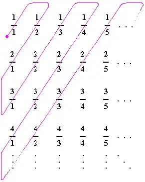

So, they have the same cardinality. Let's rationalize this by enumerating the rationals.
Note that we can 'count' all the rationals like in this picture:
There is a small detail about removing repetition, but that's okay. Here, for example, we might count $1, 1/2, 2, 3,$ (skip $2/2$), $1/3 ,$ ...
This describes a function from $\mathbb{N} \to \mathbb{Q}^+$. In fact, it's a bijection, so it serves as a counterexample to both.
