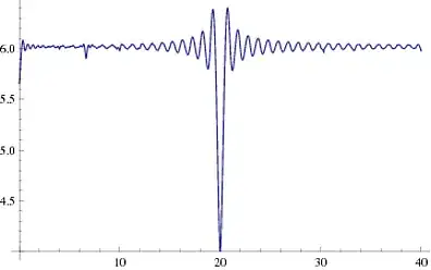

If we see what happens if we keep $\beta$ large but fixed and vary $\alpha$, we see that $\beta \approx \alpha$ with $f(\alpha,\beta) \approx 4$ looks like a minimum of the function and it quickly approaches $2\pi$ (at least for $\alpha$ large) for $\beta$ sufficiently different from $\alpha$. However, there are oscillations on top of the mean value $2\pi$. In the figure you see a numerical evaluation of the integral for $\beta=20$ and $\alpha$ between 0 and 40.
numerical evaluation of f as a function of alpha with beta=20 fixed

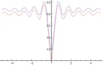

Set $\alpha-\beta = r$ and $\alpha+\beta =s$. So our integral is $$f(r,s) := \int_0^{2 \pi} \sqrt{1-(\cos (rx) + \cos (sx))/2} dx.$$ It looks like, for $r$ constant and $s$ large, a pretty good approximation is just to ignore the $s$ term. Set $$g(r) := \int_0^{2 \pi} \sqrt{1-\cos (rx)/2} dx.$$ The figure below shows $f$ (in red) and $g$ (in blue) for $s=40$. enter image description here

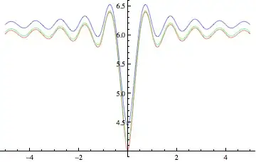

Set $$h(r) := \int_0^{2 \pi} \left( \left(1-\cos(rx)\right)^{1/2} - \frac{1}{64} \left(1-\cos(rx)\right)^{-3/2} \right) dx.$$ Here is the above plot with $h$ added on (in green) enter image description here

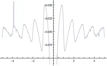

Here is a plot of $f(r,40)-h(r)$ (note the small vertical range). I wouldn't trust this data too much -- the jaggedness is often a sign that we are getting close to Mathematica's numerical tolerance: enter image description here

  • Does this mean that the limit $\lim_{t\to\infty}[\lim_{s\to\infty} f(r,s)]$ does not exist? – Fabian Mar 29 '12 at 14:47
  • I assume that $t$ is meant to be $r$. I don't know, but I would guess that that limit DOES exist. Looking at $g(r)=\int_{0}^{2 \pi} \sqrt{1-\cos(rx)/2} dx$, we have $g(r)=2 \pi \frac{1}{2 \pi r} \int_0^{2 \pi r} \sqrt{1 - \cos(u)/2}$ so $\lim_{r \to \infty} g(r)$ is $2 \pi$ times the average value of $\sqrt{1-\cos(u)/2}$, which exists. I would guess that $f(r,s)$ behaves the same way. – David E Speyer Mar 29 '12 at 15:17
  • According to Mathematica, the limit thus would be $2\sqrt{2} E(i \sqrt{2}) \approx 6.178$ which is different from @joriki's answer. – Fabian Mar 29 '12 at 16:53
  • Sorry, I was probably unclear. I suspect that $\lim_{s \to \infty} f(r,s)$ exists; call that limit $\ell(r)$. It looks like $g$ is a pretty good approximation to that limit and that $h$ is a better one. I don't think that either of them are equal to $\ell$, or even that $\lim_{r \to \infty} g(r)$ is equal to $\lim_{r \to \infty} \ell(r)$. – David E Speyer Mar 29 '12 at 18:11
  • @Fabian: I don't think that "the" limit exists. It depends very much on how you go to $\infty$. My answer shows, that for $\alpha=r\beta$ there are solutions depending on $r$. Davids solution shows, that for $\alpha = \beta + c$ there are different solutions depending on $c$. You could think of other "paths" to $\infty$ like $\alpha=c \beta^2$ and they will probably result in other answers (most of which will at least be close to $2\pi \langle\sqrt{1-\cos(x)\cos(y)}\rangle_{x,y}$). – example Mar 30 '12 at 17:04
  • @David: you did the same mistake I did at first. You cannot simply ignore the $\cos(sx)$ term completely. At least not to get to the limit (as an approximation it is of course right). So $\lim_{r\rightarrow\infty}g(r)$ is equal to $2\pi\langle\sqrt{1-cos(x)}\rangle_x$ but not necessarily $f$ (where $\langle\cdot\rangle_x$ is the average over all $x$). See jorikis or my answer. – example Mar 30 '12 at 17:09
  • @example I agree with everything you are saying, except where you say that I have made a mistake. The exact limit is not $\int \sqrt{1-\cos(rx)/2} dx$, that is a good approximation. I suspect we can get the exact limit by using all of the terms of the Taylor series, converting the $\cos(sx)^j$ terms into $\cos(msx)$ terms (as in http://math.stackexchange.com/questions/117061 ), and THEN dropping out all $\cos(msx)$ terms using Riemmann-Lebesgue, should compute the exact limit. But there is lots of analysis there which I haven't justified, which is why I only gave the approximation. – David E Speyer Mar 30 '12 at 17:26
  • @example And Fabian asked about $\lim_{r \to \infty} \lim_{s \to \infty} f(r,s)$, which is one particular path to the limit, and one for which I suspect (but haven't proved) the limit exists. Other paths will quite possibly yield different limits. – David E Speyer Mar 30 '12 at 17:27
  • @David: I'm not sure from your comments whether you think that $\lim_{s \to \infty} f(r,s)$ should be $6.01987\ldots$, as I argued. – joriki Apr 03 '12 at 00:51
  • @joricki For every value of $r$? No. We know that this is false for $r=0$, where the limit is $4$. I don't think it should be for other fixed finite values of $r$ either. – David E Speyer Apr 03 '12 at 01:15
  • Possibly I introduced too much confusion by using the same notation $f$ after I changed from the $\alpha$, $\beta$ variables to the $r$, $s$ variables? We are talking about $\lim_{s \to \infty} \int_0^{2 \pi} \sqrt{1-(\cos(rx) + \cos(sx))/2} dx$. – David E Speyer Apr 03 '12 at 01:17
