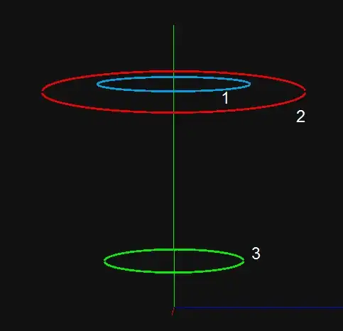

Let's say we were able to obtain two conics $C_1$, $C_2$. As you can see here these conics have no real intersection points therefore we have two pairs of complex conjugate points:
\begin{align*} x_1 &= 1265.62 - 136.414i & y_1 &= 790.132 + 38.3403i \\ x_2 &= 1265.62 + 136.414i & y_2 &= 790.132 - 38.3403i \\ x_3 &= 334.378 + 136.414i & y_3 &= 790.132 + 38.3403i \\ x_4 &= 334.378 - 136.414i & y_4 &= 790.132 - 38.3403i \end{align*}
The paper says we can use any additional conic to resolve this problem. Let's add another conic $C_3$. The intersection points of $C_1$ and $C_3$ are:
\begin{align*} x_1 &= 800 - 9360.25i & y_1 &= 1696.11 - 0.00008i \\ x_2 &= 800 + 9360.25i & y_2 &= 1696.11 + 0.00008i \\ x_3 &= 800 - 2347.41i & y_3 &= 541.402 - 0.00002i \\ x_4 &= 800 + 2347.41i & y_4 &= 541.402 + 0.00002i \end{align*}
The intersection points of $C_2$ and $C_3$ are:
\begin{align*} x_1 &= 800 - 1767.11i & y_1 &= 446.355 - 0.0001i \\ x_2 &= 800 + 1767.11i & y_2 &= 446.355 + 0.0001i \\ x_3 &= 800.238 - 555946i & y_3 &= 91806.1 + 0.039i \\ x_4 &= 800.238 + 555946i & y_4 &= 91806.1 - 0.039i \end{align*}
Here is the picture of all three conics: Here is the picture of all three
So how can we say what intersection points are the image of circular points?

If your three conics are the images of three circles in a common plane or in parallel planes, then these three conics must have a conjugate complex pair of points in common, which will be the images of $\mathbf i$ and $\mathbf j$. In your setup, there is no such common point, therefore at least one of the conics either isn't the image of a circle at all, or is the image of a circle in some other plane not parallel to the others.
I'm not sure if this is what you did, but simply picking any conic $C_3$ will be of no use. It really has to be a conic fitted to points of a tracked circular movement.
This whole approach of identifying the images of the circle points reminds me of this other beautiful question.
MvG
  • 44,006
  • Yes, all three conics are fitted to points of a tracked circular movement. But there could be inaccuracy in tracking points or fitting conics. Is there any way to use this technic in situation when data is scattered so it could turn out that conics do not lie on parallel planes? How can I be sure they do lie on parallel planes? – Paul Apr 09 '15 at 16:01
