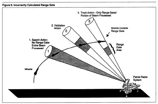

44
Perhaps you might think this answer won't be appropriate for the mathematics Stack Exchange site, but rather for Stack Overflow or Programmers. But really, the deaths in this instance may have been influenced by a lack of rigour in programming of a mathematical system, so I thought it might apply.
In 1991, 28 soldiers were killed by an Iraqi Scud missile at an army barracks in Dharan, Saudi Arabia, during the Gulf War. A Patriot missile system was programmed incorrectly resulting in a floating point error on the internal clock of the system resulting in a time error of approximately 0.34 seconds at the time of the incident.
Combined with the Scud velocity of ~1676 m/s, the Patriot missile system radar incorrectly placed the missile over half a kilometer from its true position, which was incidentally outside of its "range gate". From what I have gathered, the Patriot system essentially looked in the wrong place of the sky because of this and failed to shoot the missile down.
It may not necessarily be 100% true that this error caused the deaths. Who knows if the Patriot missile would have hit the Scud even if it weren't for the error. Thus, this may not really answer your question perfectly, but it certainly highlights the importance of rigour when applying math to real systems.
Additional
From the GAO report:
On February 11, 199 1, the Patriot Project Office received Israeli data identifying a 20 percent shift in the Patriot system’s radar range gate after the system had been running for 8 consecutive hours. (Figure 4 depicts the location of a Scud within the range gate after the Patriot has been in operation for over 8 hours.) This shift is significant because it meant that the target (in this case, the Scud) was no longer in the center of the range gate. The target needs to be in the center of the range gate to ensure the highest probability of tracking the target. As previously mentioned, the range gate is calculated by an algorithm that determines if the detected target is a Scud, and if the Scud is in the Patriot’s firing range. If these conditions are met, the Patriot fires its missiles.......Patriot Project Office officials said that the Patriot system will not track a Scud when there is a range gate shift of 50 percent or more. Because the shift is directly proportional to time, extrapolating the Israeli data (which indicated a 20 percent shift after 8 hours) determined that the range gate would shift 50 percent after about 20 hours of continuous use. Specifically, after about 20 hours, the inaccurate time calculation becomes sufficiently large to cause the radar to look in the wrong place for the target. Consequently, the system fails to track and intercept the Scud

    That's not my understanding of the failure. Rather, the computer tried to plot an intercept course against the missile and it was plotting the inbound and the Patriot at different times, causing the tracks to not converge. I do not think this case should be counted, though, as the Patriot had an abysmal record against Scuds--had it fired it almost certainly would have failed anyway. – Loren Pechtel Apr 07 '15 at 04:12
  • I am not entirely sure, as I have only read the small excerpts I have found. But your comment prompted me to search a bit more and I have linked the full GAO report in my answer. One of the opening pages, under "Results in Brief", states...At the time of the incident, the battery had been operating continuously for over 100 hours. By then, the inaccuracy was serious enough to cause the system to look in the wrong placefor the incoming Scud. I am not really sure if there is a difference between what you are saying and what I'm saying. – krb686 Apr 07 '15 at 05:33
    In other words, perhaps "looking in the wrong place of the sky" really means plotting an intercept course at the wrong place of the sky. – krb686 Apr 07 '15 at 05:37
  • Oh you are highlighting the patriot battery plotting the courses at different times as opposed to thinking the missile was elsewhere. Everything I have read/seen seems to indicate that the battery thought the missile was in the wrong place. See the quote/picture I have added to my answer. – krb686 Apr 07 '15 at 05:46

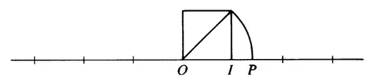

The integers are abstractions arising from the process of counting finite collections of objects. The needs of daily life require us in addition to counting individual objects, to measure various quantities, such as length, weight, and time. To satisfy these simple measuring needs, fractions are required, for seldom will a length, as an example, appear to contain an exact integral number of linear units. Thus, if we define a rational number as the quotient of two integers $p/q, q\neq 0$, this system of rational numbers, since it contains all the integers and fractions, is sufficient for practical measuring purposes.
The rational numbers have a simple geometric interpretation. Mark two distinct points $O$ and $I$ on a horizontal straight line ($I$ to the right of $O$) and choose the segment $OI$ as a unit of length:
If we let $O$ and $I$ represent the numbers $0$ and $1$, respectively, then the positive and negative integers can be represented by a set of points on the line spaced at unit intervals apart, the positive integers being represented to the right of $O$ and the negative integers to the left of $O$. The fractions with denominator $q$ may then be represented by the points that divide each of the unit intervals into $q$ equal parts. Then, for each rational number, there is a point on the line.
To the early mathematicians, it seemed evident that all the points one the line would in this way be used up. It must have been something of a shock to learn that there are points on the line not corresponding to any rational number. This discovery was one of the greatest achievements of the Pythagoreans. In particular, the Pythagoreans showed that there is no rational number corresponding to the point $P$ on the line where the distance $OP$ is equal to the diagonal of a square having a unit side (see the above figure). Their discovery marks one of the great milestones in the history of mathematics.
To prove that the length of the diagonal of a square of unit side cannot be represented by a rational number, it suffices to show that $\sqrt{2}$ is irrational. Many algebraic proofs of this fact exist, and a geometric one is provided in the article linked to at the beginning of this post.
The discovery of the existence of irrational numbers was surprising and disturbing to the Pythagoreans. First of all, it seemed to deal a mortal blow to the Pythagorean philosophy that all depends upon the whole numbers. Next, it seemed contrary to common sense, for it was felt intuitively that any magnitude could be expressed by some rational number. The geometrical counterpart was equally startling, for who could doubt that for any two given line segments one is able to find some third line segment, perhaps very very small, that can be marked off a whole number of times into each of the two given segments? But take as the two segments a side $s$ and a diagonal $d$ of a square. Now if there exists a third segment $t$ that can be marked off a whole number of times into $s$ and $d$, we would have $s=bt$ and $d=at$, where $a$ and $b$ are positive integers. But $d=s\sqrt{2}$, whence $at=bt\sqrt{2}$; that is, $a=b\sqrt{2}$, or $\sqrt{2}=a/b$, a rational number. Contrary to intuition, then, there exist incommensurable line segments.

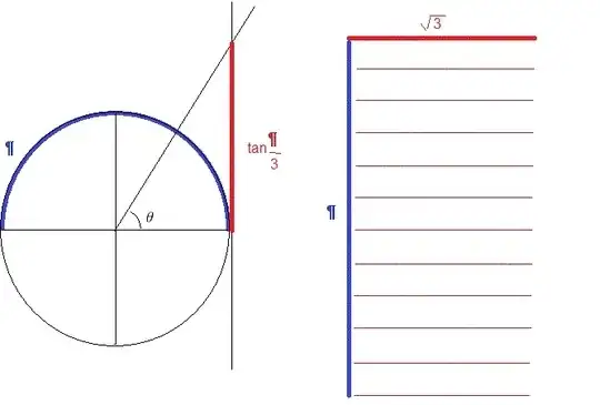

ok was joking :D time for serious answers
considering an infinite euclidean plan isometry
this graph shows how is a product of two irrational amounts is abstractly feasible (but not perfectly calculable since the human brain conception is bounded to decimal values)
the value shadowed in blue equals to $\int_{0}^{\pi} \sqrt{3}$ ~= $5.44$
the last rounded value is not yet authentic because when we draw a $3.14$ segment perpendicular to $1.73$ long segment we end up with a result nearby $5.43$ this difference of $0.01$ would be gradually and progressivly leading to a killing mistake.
This is an example of deadly inaccuate rounded up error percent.

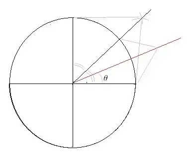

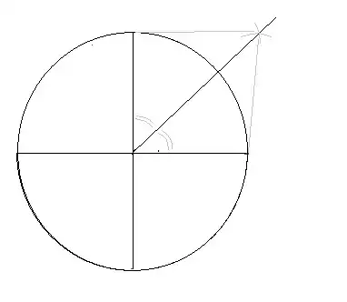

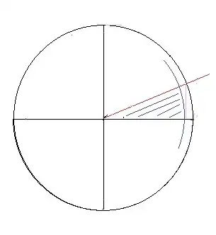

I will show you now the steps you need to get an irrational product value on your graph paper , take a compass , and a pen , and a ruler with measures.
first draw a circle of radius $r=1Dm = 10cm$ , and draw bissectrice of $\pi/2$ with same compass ...
Take same compass again , draw the bissectrice of the angle $\pi/4$ , now you have an angle $\theta=\pi/8$
Draw the projective point on $x$ axis , then take the same compass , and draw a half circle of radius = the segment from the center to the projection of the angle $\theta$
length of new radius is $cos \theta$=$cos \pi/8$
$cos \pi/4 = cos(2(\pi/8))=2cos²(\pi/8)-1$
$cos \pi/8 = \sqrt{\frac{cos (\pi/4) + 1}{2}}= \frac{\sqrt{\sqrt{2}+2}}{2}$
the surface of the blue shadowed segment = $\pi*r^2/8=\frac{\sqrt{2}+2}{24}\pi$
Now be happy :D you have just drawn an irrational product of class $ \pi*\mathbb{N}^{1/2}$ by your own bare hands !!! and it does never equals the approximate decimal calculation result whic is nearby $44.7 mm$
