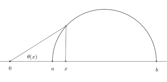

The integrand is the angle $\theta(x)$ in this diagram. I tried to find a geometric explanation for the OP's integral, but I failed. Maybe someone else can succeed?
