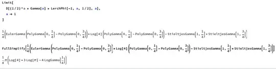

$$\implies I=\frac12\lim_{a\to1}\frac{\partial}{\partial a}\int_0^\infty \frac{x^{a-1}}{\cosh(x)}\,dx$$
Using this,
$$\color{red}{\int_0^\infty \frac{x^{a - 1}}{\cosh(x)} \, dx = \frac{1}{2^{a-1}} \Gamma(a) \Phi\left(-1, a, \tfrac{1}{2} \right)}$$
$$\implies I=\lim_{a\to1}\frac{\partial}{\partial a}\frac{1}{2^{a}} \Gamma(a) \Phi\left(-1, a, \tfrac{1}{2} \right)$$
Using,
$$I=\frac{1}{4} \pi \left( \log 4 + 3 \log \pi - 4 \log \Gamma\left( \tfrac{1}{4} \right) \right)$$
