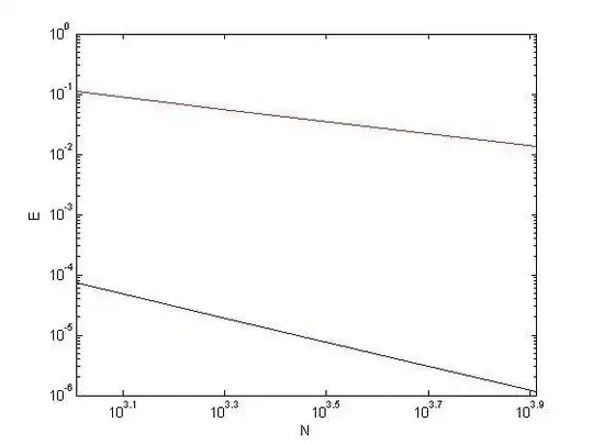

     rho=0.000000, p_max=1.083617
p1() is given from the relation:
p1(i)=(log(E(N(i-1))/E(N(i)))/(log((1./N(i-1))/(1./N(i)))));
p1_max() is the maximum p1() for a specific rho.
p_max is the maximum values of all p1_max(). We get this values for rho=0.000000
But this cannot be trues, because that would mean that backward Euler method has the maximum order.

EDIT 5: The results for the changed version of the function of the exact solution are the following:
     rho= 0.000000
     i=1.000000 N(1.000000)=1024.000000000  y(1) =  2.82672652466  , error=0.1084446962030
     i=2.000000 N(2.000000)=2048.000000000  y(1) =  2.77191911745  , error=0.0536372889879
     i=3.000000 N(3.000000)=4096.000000000  y(1) =  2.74495619768  , error=0.0266743692175
     i=4.000000 N(4.000000)=8192.000000000  y(1) =  2.73158318927  , error=0.0133013608113
     rho= 0.250000
     i=1.000000 N(1.000000)=1024.000000000  y(1) =  2.77195961188  , error=0.0536777834160
     i=2.000000 N(2.000000)=2048.000000000  y(1) =  2.74496607477  , error=0.0266842463094
     i=3.000000 N(3.000000)=4096.000000000  y(1) =  2.73158562815  , error=0.0133037996933
     i=4.000000 N(4.000000)=8192.000000000  y(1) =  2.72492418927  , error=0.0066423608061
     rho= 0.500000
     i=1.000000 N(1.000000)=1024.000000000  y(1) =  2.71833321749  , error=0.0000513890326
     i=2.000000 N(2.000000)=2048.000000000  y(1) =  2.71829467535  , error=0.0000128468916
     i=3.000000 N(3.000000)=4096.000000000  y(1) =  2.71828504016  , error=0.0000032117000
     i=4.000000 N(4.000000)=8192.000000000  y(1) =  2.71828263138  , error=0.0000008029236
     rho= 0.750000
     i=1.000000 N(1.000000)=1024.000000000  y(1) =  2.66581988059  , error=-0.0524619478724
     i=2.000000 N(2.000000)=2048.000000000  y(1) =  2.69190151155  , error=-0.0263803169049
     i=3.000000 N(3.000000)=4096.000000000  y(1) =  2.70505400927  , error=-0.0132278191846
     i=4.000000 N(4.000000)=8192.000000000  y(1) =  2.71165846267  , error=-0.0066233657940
     rho= 1.000000
     i=1.000000 N(1.000000)=1024.000000000  y(1) =  2.61439291112  , error=-0.1038889173386
     i=2.000000 N(2.000000)=2048.000000000  y(1) =  2.66578322391  , error=-0.0524986045516
     i=3.000000 N(3.000000)=4096.000000000  y(1) =  2.69189211409  , error=-0.0263897143722
     i=4.000000 N(4.000000)=8192.000000000  y(1) =  2.70505163034  , error=-0.0132301981164
     p1(2.000000)= 0.984691
     p1(3.000000)= 0.992303
     p1(4.000000)= 0.996141
     rho=0.500000, p_max=2.000000
EDIT 5: That is the graph that I get for the error in respect to $N$:

def integrate(N, rho):
    h=1.0/N;
    y=1.0
    for k in range(N):
        t=k*h;
        y = y * (1+rho*h*c(t))/(1-(1-rho)*h*c(t+h));
    return y;
for k in range(5):
    rho = k/4.0;
    print "    rho = ", rho;
    N=1024;
    ylast = 0
    for i in range(4):
        y = integrate(N, rho);
        if(i>0):
            err = ylast-y
            print "    i=", i, " N=",N,"\ty(1)=",y,"\terr(",i-1,")=",err,"\tlog2|err|=",log(abs(err))/log(2);
        else:
        ylast = y;
        N *= 2;
    print "    --";
Cursory results
rho =  0.0
i= 0  N= 1024       y(1)= 2.82672652466
i= 1  N= 2048       y(1)= 2.77191911745     err( 0 )= 0.0548074072152       log2|err|= -4.18948530333
i= 2  N= 4096       y(1)= 2.74495619768     err( 1 )= 0.0269629197704       log2|err|= -5.21287945772
i= 3  N= 8192       y(1)= 2.73158318927     err( 2 )= 0.0133730084062       log2|err|= -6.22453213762
rho =  0.25
i= 0  N= 1024       y(1)= 2.77195961188
i= 1  N= 2048       y(1)= 2.74496607477     err( 0 )= 0.0269935371066       log2|err|= -5.21124215659
i= 2  N= 4096       y(1)= 2.73158562815     err( 1 )= 0.0133804466161       log2|err|= -6.22372991834
i= 3  N= 8192       y(1)= 2.72492418927     err( 2 )= 0.0066614388872       log2|err|= -7.22995044802
rho =  0.5
i= 0  N= 1024       y(1)= 2.71833321749
i= 1  N= 2048       y(1)= 2.71829467535     err( 0 )= 3.85421409912e-05     log2|err|= -14.6632037598
i= 2  N= 4096       y(1)= 2.71828504016     err( 1 )= 9.6351915686e-06      log2|err|= -16.6632552186
i= 3  N= 8192       y(1)= 2.71828263138     err( 2 )= 2.40877642854e-06     log2|err|= -18.6632680738
rho =  0.75
i= 0  N= 1024       y(1)= 2.66581988059
i= 1  N= 2048       y(1)= 2.69190151155     err( 0 )= -0.0260816309674      log2|err|= -5.26082210107
i= 2  N= 4096       y(1)= 2.70505400927     err( 1 )= -0.0131524977203      log2|err|= -6.24851938976
i= 3  N= 8192       y(1)= 2.71165846266     err( 2 )= -0.00660445339054     log2|err|= -7.24234512113
rho =  1.0
i= 0  N= 1024       y(1)= 2.61439291112
i= 1  N= 2048       y(1)= 2.66578322391     err( 0 )= -0.051390312787       log2|err|= -4.28235975665
i= 2  N= 4096       y(1)= 2.69189211409     err( 1 )= -0.0261088901794      log2|err|= -5.25931505601
i= 3  N= 8192       y(1)= 2.70505163034     err( 2 )= -0.0131595162558      log2|err|= -6.24774973324
The errors show the halving behavior except for $\rho=0.5$, where the error gets quartered. The dyadic logarithm of the error also shows that behavior by the arithmetic progressions by about $-p=-1$ except in the middle where it progresses by $-p=-2$. With a denser set of $\rho$ values one sees the error getting progressively smaller from both sides towards $\rho=0.5$ in the middle without losing the order $p=1$, with then a jump to much smaller errors at $\rho=0.5$ with order $p=2$.

  • I made some changes and now I get the same $y(1)$ as you got. Is err(i) the local error? Also what results do you get for the order $$p \approx \frac{\log \left (\frac{E(N_1)}{E(N_2)}\right )}{\log \left (\frac{h_1}{h_2}\right )}$$ ? – evinda Apr 01 '15 at 22:14
  • err(i) is the difference between the last two numerical solutions. Approximately $C·(h/2)^p-C·h^p=D·h^p$. The log2|err(i)| of that has thus, with $h=1/N=2^{-n}$, the approximate form $\log_2|D|+p·\log_2(h)=\log_2|D|-p·n$. $-p$ is thus the step of the arithmetic progression of log2|err(i)|. In the end this is the formula I gave above that does not use the exact value. However, with the exact value the only change is that the constant is $\log_2|C|$ instead of $\log_2|D|$. – Lutz Lehmann Apr 02 '15 at 07:30
  • I edited my post... Could you take a look at it? – evinda Apr 02 '15 at 08:32
  • @evinda: Since the solutions are the same, and for $\rho=0.5$ get very close to the correct result $\exp(1)$ and the difference between discretizations is as expected.... there has to be something wrong with your exact solution. And indeed, you compute as $y_{exact}(t)$ always the value $y(t-h)$ by evaluating y_ex(i+1) at t(i). This of course has automatically an error $O(h)$ that is impossible to reduce by the numerical method. – Lutz Lehmann Apr 02 '15 at 09:02
  • I changed the function at which I calculate the function and I wrote two versions: http://pastebin.com/7NnvcuDE and http://pastebin.com/mLLKbfRC .. Which do you think that is better? For both versions, I get the same results.. I will add them at the initial post.. But the error is a little different as yours. Which could be the reason? – evinda Apr 02 '15 at 17:01
  • Both look good and should give the same result. The shorter, the less space for errors. As I said above, I was lazy and did not implement the exact solution. Thus the errors should differ by a factor 4/3 (for p=2) to 2 (for p=1). – Lutz Lehmann Apr 02 '15 at 17:08
  • Also, I have to make a $\log-\log$ graph of the error $E(N)$ in respect to the number of iterations $N$ for the method with rho=0 and rho=0.5 and with $N=64,128, \dots, 4096,8192$. I added this part: http://pastebin.com/fyVWNvYy at the function order. I will add at my initial post the picture that I get.. Could you tell me if it is right? – evinda Apr 02 '15 at 17:59
    Yes, this is looking good. You could invest 20 min, but not more, into finding out if it is possible to label the scales in powers of 2. – Lutz Lehmann Apr 02 '15 at 18:40

Your last equation is exactly what you want to find $p$. If you have an analytic solution and have done numeric integration with $N_1,N_2$ steps, you can find the error for each integration. You also know the stepsizes $h_1,h_2$, so you have the whole right hand side.

So as an addendum to my comment I assume $y'=f(t,y)$ and also I assume $f$ is lipschitz continuous so there exists a unique solution, now by taylor expansion we get that $$y(t^{n+1}) = y(t^n)+hf(t^n,y(t^n))+(h^2/2)y''(\xi_1)$$ and $$y(t^{n+1}) = y(t^n)+hf(t^{n+1},y(t^{n+1}))-(h^2/2)y''(\xi_2)$$
and note that we can write $y(t^{n+1})=\rho y(t^{n+1})+(1-\rho)y(t^{n+1})$, subtracting this from our method we get: $$|y^{n+1}-y(t^{n+1})|=|y^{n+1}-(\rho y(t^{n+1})+(1-\rho)y(t^{n+1}))|$$ $$\le|y^n-y(t^n)|+h\rho|f(t^n,y^n)-f(t^n,y(t^n))|+h(1-\rho)|f(t^{n+1},y^{n+1})-f(t^{n+1},y(t^{n+1}))|$$ $$+h^2\|y''\|_\infty$$ $$\le(1+h\rho L)|y^n-y(t^n)|+h(1-\rho)L|y^{n+1}-y(t^{n+1})|+h^2\|y''\|_\infty$$ so $$|y^{n+1}-y(t^{n+1})|\le \frac{1+h\rho L}{1-hL+\rho hL}|y^n-y(t^n)|+\frac{h^2}{1-hL+\rho hL}\|y''\|_\infty,$$ iterating and letting $\gamma = \frac{1+h\rho L}{1-hL+h\rho L}$, and using the fact that $1+x+...+x^n=\frac{x^{n+1}-1}{x-1}$ we get $$|y^{n+1}-y(t^{n+1})|\le\frac{\gamma^{n+1}-1}{\gamma -1}\frac{h^2}{1-hL+h\rho L}\|y''\|_\infty$$

  • @LutzL also $\gamma = O(1)$, so $1+\gamma+...+\gamma^n=\frac{\gamma^{n+1}-1}{\gamma-1}=O(1)$ also, so it doesn't affect the order – Ellya Mar 31 '15 at 07:30
  • That is true, but strange. For $ρ=1$ the method is Euler forward, for $ρ=0$ Euler backward, both of global error order $1$. It would be truly revolutionary if the $O(h^2)$ bound were valid. – Lutz Lehmann Mar 31 '15 at 07:36
  • My earlier remark remains: Since $ γ=1+Lh+O(h^2)$ one gets $γ^n=exp(n*(Lh+O(h^2))=exp(Lt_n+O(t_nh))$ so that the numerator is in the first order independent of $h$ and the denominator $γ-1=Lh+O(h^2)$ is in the first order proportional to $h$. Your bound is thus $O(e^{LT}h)$ for any fixed end time $T\gg h$. – Lutz Lehmann Mar 31 '15 at 08:11
