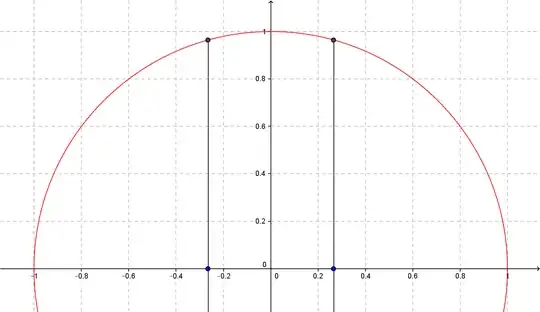

Graphic for r = 1

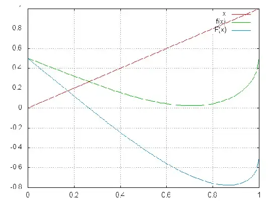

Numerical Solution (Fixed Point):
Another way to pose the problem is as a fixed point equation:
$$ f(z) := \sin\left( \frac{\pi}{6} - z \sqrt{1-z^2} \right) = z $$
This you can solve already roughly with a function plot program like Gnuplot py proper panning and zooming:
fixed point and root version for r = 1
The image shows where $y = x$ and $f(x)$ cross, the $x$ coordinate is the fixed point. I added the root version $F(x)$ as which has the root there.
Otherwise one can fixed point iteration (depending if the fixed point is attractive or not one might need to do this with a transformed $g$).
Newton iteration convergers much faster, meaning needs less iterations to gets digits of the result.
