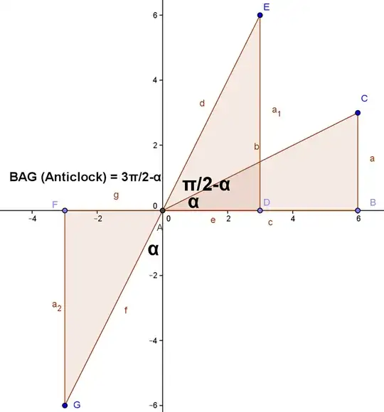

Hope this picture solves it for you.

Hint $cos(a-b)=\cos(a)\cos(b)+\sin(a)\sin(b)$ can you get it now.
