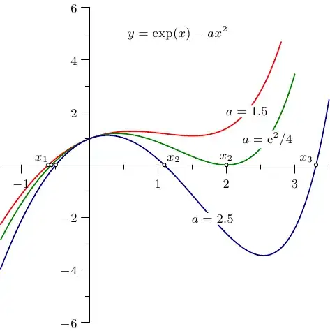

For $a>0$ the roots can be expressed in terms of Lambert $W$ function:
\begin{align} a x^2&=\exp(x) \\ x^2\exp(-x)&=\frac{1}{a} \\ x\exp(-\frac{x}{2})&=\pm\frac{1}{\sqrt{a}} \\ -\frac{x}{2}\exp(-\frac{x}{2})&=\mp\frac{1}{2\sqrt{a}} \\ -\frac{x}{2}&=\mathrm{W}\left( \mp\frac{1}{2\sqrt{a}} \right)\\ x&=-2\mathrm{W}\left( \mp\frac{1}{2\sqrt{a}} \right) \end{align}
So, $\forall a>0$ there is always one negative real root $x_1=-2\mathrm{W_0}\left(\frac{1}{2\sqrt{a}} \right)$. And since the Lambert $W(u)$ function has two real branches for $-\exp(-1)<u<0$, it would be two more (positive) real roots (three total):
\begin{align} x_2&=-2\mathrm{W_0}\left(-\frac{1}{2\sqrt{a}} \right), \\ x_3&=-2\mathrm{W_{-1}}\left(-\frac{1}{2\sqrt{a}} \right) \end{align} for $a>\exp(2)/4$.
Also, when $a=\exp(2)/4$ then $x_2=x_3$ and there are two real roots total.
Summarizing, the number $n$ of real roots to $\exp(x) = a x^2$: \begin{align} n&= \begin{cases} 0,\quad a\le0 \\ 1,\quad 0<a<\exp(2)/4 \\ 2,\quad a=\exp(2)/4 \\ 3,\quad a>\exp(2)/4 \\ \end{cases}. \end{align}
