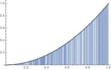

Example 1: Using the method above with $n = 1000$, we get the plot:
This produces $I = 0.3323369730904328$.

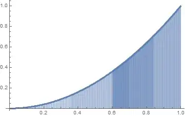

Example 2: Using a Quasi-Monte-Carlo method with $n = 1000$, we get the plot:
This produces $I = 0.3332527188916689$.

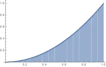

Example 3: Using an Adaptive-Monte-Carlo method with $n = 1000$, we get the plot:
This produces $I = 0.333727841861132$.
