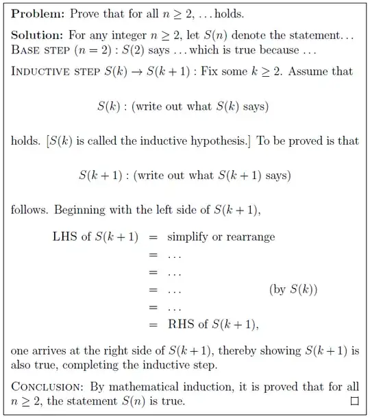

Initial comment: First of all, +1 for effort. Your questions almost always show a lot of it. Also, I can see you are trying to actively improve based on questions like this, where you are clearly trying to implement the advice given by users on here. That's great. Based on several of your questions, your induction ones anyway, it seems that one of the chief struggles you have is in actually writing the proof well (that is, making it clear, polished, etc.). Thus, at the end of this post, I'll provide you with a template for writing induction proofs adapted from David Gunderson's Handbook of Mathematical Induction (something tells me you would really like this book by the way). It helped me immensely when I was starting out.

Template: As promised, here's a template you can use from now on that should greatly assist you in writing up clear induction proofs.
  • Wow, thanks for such a complete answer to my question! I definitely agree in that it appears I am lacking many of the aesthetics in my proofs. And thank you for pointing out that this problem is indeed among a more general class of series as I did not make the connection (it even stated it in the chapter). I'll see if I cannot find that book you mentioned as I think I would find it helpful. Questions: 1) Is it a good idea to explicitly state "Base Step ($n = 0$ etc.): continue..." and then "Inductive Step $\left(P\left(k\right)\right)\implies\left(P\left(k+1\right)\right)$: continue" ? – bjd2385 Mar 18 '15 at 03:07
    @jm324354 You're welcome :) Honestly, I think it's sufficient enough to simply write "base case" and then "inductive step." I just try to write up my answers as clearly as possible in general. :) – Daniel W. Farlow Mar 18 '15 at 03:12
