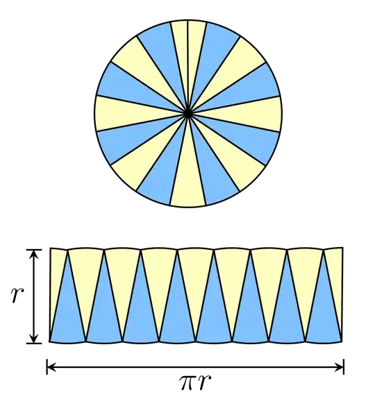

I prefer the following illustration.
"CircleArea" by Jim.belk - Own work. Licensed under Public Domain via Wikimedia Commons.

if you assume that $\pi$ is the ratio of the diameter of the circle to the circumference, then you can divide the circumference, say, into $1000$ points at equal distance. now join each of these segments to the center to make a small pie. arrange the pieces so that they make an almost rectangle of length $\pi \times \text {radius}$ and width the radius of the circle. the area of this rectangle is $\pi$ times the radius squared.
