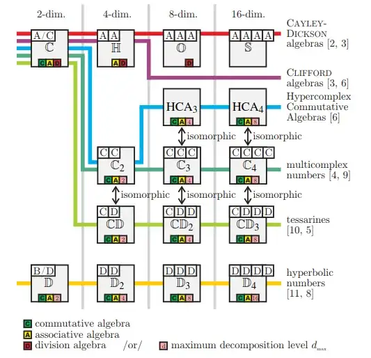

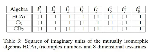

Bicomplex numbers, or tessarines is a commutative algebra as other people said.
It has zero divisors. And I would say, being commutative is a lot more important than disadvantages from zero divisors!
Moreover, zero divisors are not a disadvantage at all, because it allows bicomplex numbers to generalize not only the concept of complex numbers, but also hyperbolic (split-complex) numbers. They are included in bicomplex numbers and have zero divisors.
There is nothing essentially bad regarding zero divisors: this means that we have some elements by which we cannot divide, but we anyway had one such real number: zero.
They can be represented as real matrices of certain structure with usual matrix operations, so one can experiment with them in any computer algebra system that allows to apply analytic functions to matrices.
Images source:https://citeseerx.ist.psu.edu/viewdoc/download?doi=10.1.1.527.356&rep=rep1&type=pdf

  • Despite the zero divisors, what you say about dual numbers is incorrect. There are no nonzero solutions of $z^2=0$ in the bicomplex numbers. – J.G. Feb 14 '21 at 10:28
  • @J.G. but if one adds dual unity over it, the algebra remains commutative and associative. – Anixx Feb 14 '21 at 10:34
  • @J.G. This paper describes tessarines and dual hyperbolic: https://www.jcscm.net/fp/126.pdf – Anixx Feb 14 '21 at 10:35
