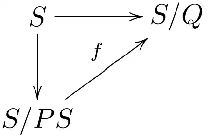

Now since $-23 \equiv 1 \pmod{8}$ by knowledge of how primes split in quadratic extensions we know that $2R = (2,\theta)(2,\bar{\theta})$ where $\bar{\theta}$ is the other Galois conjugate of $\theta$ over $\Bbb{Q}$. It will now follow that $f(P|(2)) = 1$ and so we conclude that $f(Q|P) = 11/1 = 11$. For the last part of this problem, we know already that $S/PS$ is an $11$ - dimensional $R/P$ vector space. Since this is equal to $f(Q|P)$, we see that the map $f$ in the diagram
is a surjective map between two finite sets of the same size and hence is injective. It follows that $PS = Q$, i.e. that $(2,\theta) = Q$ in the ring $S = \Bbb{Z}[w]$.

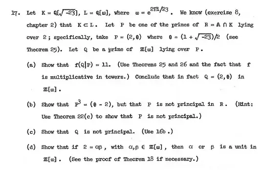

"Number Fields" by Daniel A. Marcus has a guided exercise that proves your question - see chapter 3, exercise 17 (page 86):enter image description here
