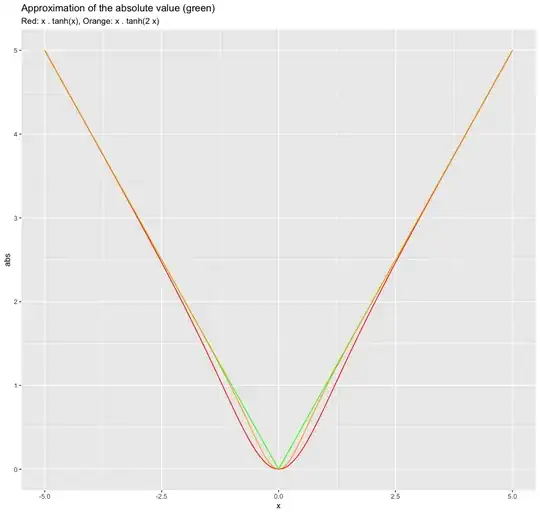

enter image description hereJust simply $$x. \tanh(\alpha x)$$ Example plot
