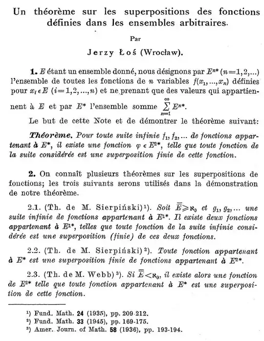

Yes, during the 1930's and 1940's Sierpinski researched compositions of operations ("clones") and proved that every $n$-ary operation on a set is a finite composition of binary operations on the set, see W. Sierpinski, Sur les fonctions de plusieurs variables, Fund. Math. 33 (1945), 169-173. See also see Jerzy Los's paper, excerpted below. A proof is also in Paul Cohn's Universal Algebra. For some recent work on related topics see Gratzer, A Survey of some Open Problems on $p_n$-Sequences and Free Spectra of Algebras and varieties.
A proof is especially simple for operations on a finite set $\rm A.\,$ Namely, if $\rm\,|A| = n\,$ then we may encode $\rm A $ by $\rm\,\mathbb Z/n,\,$ the ring of integers $\!\rm \bmod n,\,$ allowing us to employ Lagrange interpolation to represent any finitary operation as a finite composition of the binary operations $\rm\, +,\ *\,,\,$ and Kronecker delat $\rm\, \delta(a,b) := 1\,\ if\,\ a=b\,\ else\,\ 0,\,$ namely
$$\rm f(x_1,\ldots,x_n)\ =\!\!\!\!\!\!\! \sum_{(a_1,\ldots,a_n)\ \in\ A^n\!\!\!\!\!}\!\!\!\!\! f(a_1,\ldots,a_n) \prod_{i\ =\ 1}^n\ \delta(x_i,a_i)\qquad $$
When $\rm\,|A|\,$ is infinite one may instead proceed by employing pairing functions $\rm\,A^2\to A\,.$
