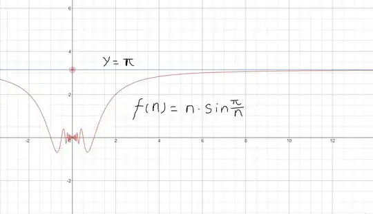

Since $\lim_{x \to 0}$$\sin x \over x$$=1$,here let $x=$$\pi\over n$ , then we have $\lim_{{\pi\over n} \to 0}$$\sin {\pi\over n} \over {\pi\over n}$$=1$ , which implies $\pi=$$\lim_{n \to\infty}$$\ n*sin {\pi\over n}$ Plot of the function $\ n*sin {\pi\over n}$ Here is the link of the animated graph of this method: Approximation of Pi
The idea is to evaluate $\pi$ by assigning a very large number to $n$, and then calculate the corresponding value of the function $f(n)=n*sin {\pi\over n}$ using a computer program: the bigger $n$ is, the closer to $\pi$ it will be.

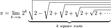

From Wikipedia:
The thing on the right is equal to $2^{k+1}\sin(\frac\pi{2^{k+1}})$, which is your equation with $n=2^{k+1}$.
  • You can use this to get $\pi$ up to six decimal-places accuracy (due to rounding errors) on a TI-84. First, press 0 and then ENTER. Then, type $\sqrt{2+\textrm{Ans}}$ and then ENTER ten times. Then, press $\sqrt{2-\textrm{Ans}}$ and ENTER, and finally press $\textrm{Ans}\times2^{11}$. – Akiva Weinberger Feb 26 '15 at 02:36
  • (Photo taken from here. It's in Related Formulas.) – Akiva Weinberger Feb 26 '15 at 02:41
