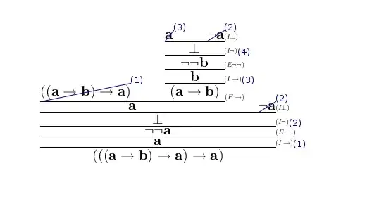

Here's the proof you are looking for. You can find more information here.
((a->b) -> a )-> b proof
This proof was constructed using the Panda Proof assistant.
Or in Fitch format: $$\def\fitch#1#2{\quad\begin{array}{|l}#1\\\hline#2\end{array}}\fitch{}{\fitch{~~1.~~(p\to q)\to p\hspace{8ex}:\text{assumption}}{\fitch{~~2.~~\lnot p\hspace{8ex}:\text{assumption}}{\fitch{~~3.~~p\hspace{8ex}:\text{assumption}}{~~4.~~p\land\lnot p\hspace{8ex}:\text{conjunction introduction}\\~~5.~~q\hspace{8ex}:\text{explosion (ex falso quodlibet}}\\~~6.~~p\to q\hspace{8ex}:\text{conditional introduction}\\~~7.~~p\hspace{8ex}:\text{conditional elimination (modus ponens)}\\~~8.~~p\land\lnot p\hspace{8ex}:\text{conjunction introduction}}\\~~9.~~\lnot\lnot p\hspace{8ex}:\text{negation introduction}\\10.~~p\hspace{8ex}:\text{double negation elimination}}\\11.~~((p\to q)\to p)\to p\hspace{8ex}:\text{conditional introduction}}$$
