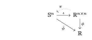

However, there is another interpretation for the same notation, which becomes clear if we name the functions we use. Consider the following diagrams
where $\iota$ is the natural embedding, $\pi$ the projection $\pi(Y)=(1/2)(Y+Y^T)$, $\phi$ is as above, $\bar{\phi}$ is just the restriction of $\phi$ and $\psi$ is given by
\psi(Y) = a^T(Y+Y^T)b/2.
These diagrams aren't equivalent. In fact, the one on the left does not commute with regards to $\pi$, while the one on the right fully commutes.
