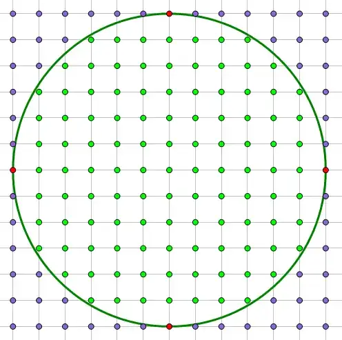

Here's one way you can try at home: Draw a large circle centered at the origin with radius $r$ on a lattice grid, inscribed in a square with side length $2r$. The ratio of integer coordinate points interior to the circle compared to the bounding box's area of $4r^2$ will approximate $\pi/4$. As you increase the radius and points considered, this will give you better approximations to the area of the circle, although the counting becomes inefficient for large values.
circle on integer grid
The Ancient Greeks used a similar idea to bound a circle's area but with many-sided polygons. Later on, mathematicians devised much more efficient methods to calculate dozens, then hundreds, then millions, etc. of digits.
