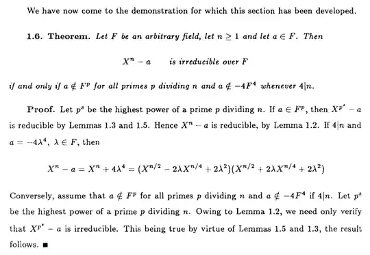

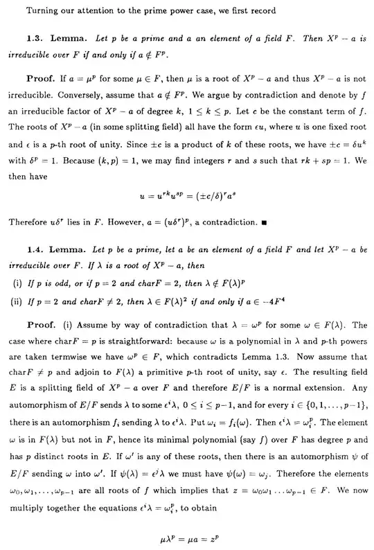

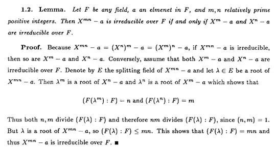

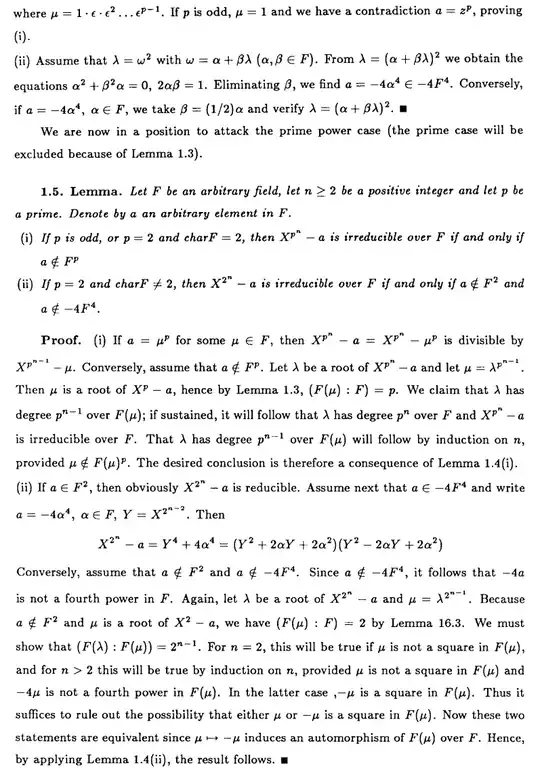

Theorem $\ $ Suppose $\,F\,$ is a field and $\:a\in F\:$ and $\:0 < n\in\mathbb Z.\ $ Then
$\ \ \ x^n - a\ $ is irreducible over $F \iff a \not\in F^{\large p}\,$ for all primes $\,p\mid n,\,$ and $\ a\not\in -4F^4$ when $\: 4\mid n $
For a proof see e.g. Karpilovsky, Topics in Field Theory, Theorem 8.1.6, excerpted below, or see Lang's Algebra (Galois Theory).
enter image description here enter image description here enter image description here enter image description here
