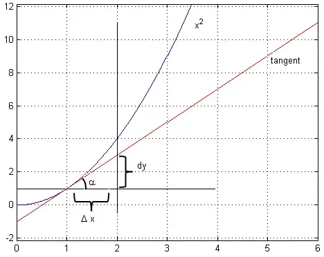

The derivative and differentials are two different things:
Consider the above picture, then from $\tan \alpha = f'(x)$ you get:
$$dy=f'(x) \Delta x$$
Therefore, differential $dy$ is described as:
$$(dy)(x,\Delta x)=f'(x)\Delta x$$
After you describe $\Delta x$ in terms of $dx$ in a similar manner you get:
$$dy=\frac{dy}{dx}dx$$
Here, $\frac{dy}{dx}$ is not a division of differentials, it is the Leibniz's notation of derivative. But wait, division of differentials is equal to the derivative. So you can pass differentials from one side to another.
Remarks:
-Recognize that the derivative is defined as an increase in the function whereas the differential is defined as an increase in the tangent line of a function.
-The difference between differential and derivative is clear when there are multiple independent variables.
-I am not an expert. I may be totally wrong in a rigorous perspective.
