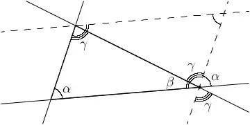

On the other hand, one has theorems such as "the total interior angle of a Euclidean triangle is equal to a straight angle", in which angles are implicitly given numerical measures. Here, an angle of $540$ degrees is certainly not a "straight angle". (One might attempt to nitpick: In the diagram, how do we know angle $\alpha$ (say) isn't one full turn plus the angle shown? This objection would be perverse: In hyperbolic or spherical geometry, the angular defect of a geodesic triangle is proportional to the triangle's area. You can't play word games with angle measurement in those settings without losing valuable theorems.)
