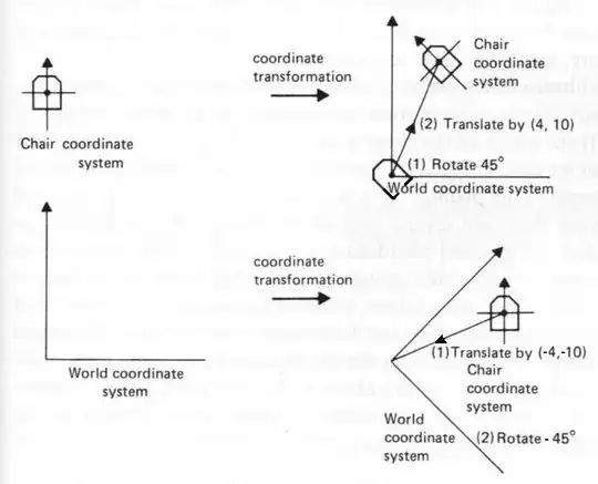

Consider a two-dimensional example, as has been found in a book about Computer Graphics (to be precise: J.D. Foley, A. van Dam, Fundamentals of Interactive Computer Graphics, 1982). There are two frames of reference, one attached to the observer (world), one attached to an object (chair):
With a transformation of coordinates, the only thing that is important is the relative position of the object with respect ot the observer. This means that the end result of a coordinate transformation can be achieved in at least two ways. As is displayed in the example:
  • Extrinsic.  Rotate $\,R\,$ the chair in the world coordinate system over an angle of $45^o$
    and then Translate $\,T\,$ it over a distance $(4,10)$. Thus resulting in a transformation $\,TR$ .
  • Intrinsic.  Translate $\,T^{-1}\,$ the observer in the chair coordinate system over a distance $(-4,-10)$ and then rotate $\,R^{-1}\,$ the world coordinate system over an angle $-45^o$. Thus resulting in a transformation $\,R^{-1}T^{-1}$ .
With this simple example, we can see immediately that the transformations are the inverse of each other: $\,R^{-1}T^{-1}= (TR)^{-1}$ .
Hope you get the idea. Generalizing this to three dimensions is expected to be a matter of filling in the (somewhat more involved) technicalities.
Update. Hmm, "not quite a proof". Then perhaps this.
Let the coordinate system of the object be called $O$ and the world coordinate system be called $W$. Both coordinate systems are coincident in the beginning.
The first step is to apply a transformation $R$ to $O$   (just as in the example, but in general now).
The second step is to make $W$ coincident again with $O$, which is done by applying the same transformation $R$ to $W$ as has been done in the first step with $O$.
Then effectively nothing has changed and we have the original configuration again: the product of step (1) and step (2) is the identity.
It is thus obvious that the first step could also have been accomplished by applying the inverse $R^{-1}$ transformation to $W$ instead of $O$.
Common properties of inverse operations like $(AB)^{-1}= B^{-1}A^{-1}$ are assumed throughout to be well known. This completes the proof.
