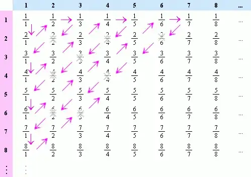

Here's an intuitive but very helpful to understand picture. enter image description here
