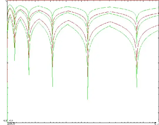

EDIT: I missed the 'Precise Value of Cube Root' using following formula : $$P=A\frac{4N-A^3}{3N}$$ (I updated the picture and added this formula as well as the third Newton iteration)
The NAHNO approximative formula is better than the first Newton iteration but weaker than the second. The precise NAHNO formula is beaten only by the third Newton approximation as you may see in this picture (the curves are from top to bottom : first Newton iteration, Approximative NAHNO, second Newton iteration, Precise NAHNO, third Newton iteration ; the NAHNO curves are darker, the vertical scale is logarithmic and 'lower is better') :
log|relerror|
The vertical axis shows $\ \log \left| \frac {A(N)}{N^{\frac 13}}-1\right|$ for $N$ in $(1000,50000)$. The vertical lines are values $N$ such that $2\sqrt[3]{N}$ is integer (when the initial estimation is nearly the solution).
So that, considered as approximate formulas, NAHNO formulas are rather good and could be made more precise with a better first approximation (especially for $x$ between $1$ and $2.5$ more values should be provided in the table). Avoiding extravagant claims could be an advantage too! :-)
