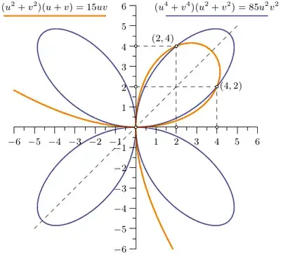

The illustration shows points of real solutions:
