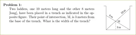

I tried to use the angles ($\cos$ and $\tan$) and the Intercept theorem but I don't know where is the trench in the figure. Is it just the base?
  • Could someone write down the steps by drawing each figure that's gonna be needed in your proof?

  • Why do you keep asking for "simple" ways? First you should find any way that works. Crossed ladder problems are rarely "simple" and usually lead to polynomial equations of degree $4$. – Rory Daulton Jan 29 '15 at 10:54
  • so what do you suggest to me to do – Educ Jan 29 '15 at 10:55
  • Given the ladder lengths $8$ and $10$ and the trench width $w$, use trigonometry to find an expression that gives you the height of the intersection point. Then set that expression to $3$ and solve. That way is straightforward. If you get that equation and cannot solve it, say so, write the equation, and ask for the solution. That will get you more respect here. – Rory Daulton Jan 29 '15 at 10:58
  • i think $$x^{4}-6x^{3}-36x^2+216x-324=0$$ but i need the steps to write it in latex – Educ Jan 29 '15 at 11:01
    For more information see here or search for "crossed ladder". – Rory Daulton Jan 29 '15 at 11:04
  • its about $$x=6,326 m$$ by using Newton's method – Educ Jan 29 '15 at 11:05
  • @RoryDaulton is the trench the distance between two walls or distance between them+the high of each of them ? – Educ Jan 29 '15 at 12:55
  • In these equations, $x$ is the width of the trench, the distance between the two walls. Your value of $x$ makes $1599942041036476=0$ so it seems a little off. My graphing calculator gives $x\approx 7.74463787384$ as the only solution for $0\le x\le 10$. – Rory Daulton Jan 29 '15 at 13:30

  • @Educ If $x > 10$ the ladder wouldn't be leaning against the wall... and $x<0$ seems a little inconvenient as a distance. – PierreCarre Mar 29 '19 at 13:57
  • @Educ There is a confusion here: in your quartic, $x$ is the height at which the $10\ m$ ladder reaches the opposite wall, while the final value you give is the correct width of the trench. – someone Apr 01 '19 at 15:24

There is no need to use trigonometry here: the Intercept theorem leads to the first equation of $\left(1\right)$ and the Pythagorean theorem leads to the second and third equations of $\left(1\right)$.
The crossed ladders problem is a special case of the system of equations $\left(1\right)$.
\begin{equation} \begin{split} h_1h_2&=h\left(h_1+h_2\right)\\ h_1^2&=l_2^2-w^2\\ h_2^2&=l_1^2-w^2\\ \end{split} \tag 1 \end{equation}
$h$, $l_1$, and $l_2$ are known real numbers.
$h_1$, $h_2$, and $w$ are unknown complex numbers.
The general analytical solution can be found as shown below and applied to any such problem.

Applying the solution to the given problem
Let $h=3\ m$, $l_j=8\ m$, and $l_k=10\ m$.
The values in the only triplet containing only real positive values are:
\begin{equation} \begin{split} R_{k1}^{'}&=6\sqrt[3]{35+3\sqrt{129}}+6\sqrt[3]{35-3\sqrt{129}}\\ R_6^{'}&=3\sqrt[3]{262+6\sqrt{129}}+3\sqrt[3]{262-6\sqrt{129}}\\ h_{j4}&=\frac{3-\sqrt{33-R_{k1}^{'}}+\sqrt{66+R_{k1}^{'}+6\sqrt{105+6\sqrt[3]{3547+27\sqrt{129}}+6\sqrt[3]{3547-27\sqrt{129}}}}}{2}\\ &\approx7,7446378738165\ m\\ h_{k4}&=\frac{\sqrt{6\sqrt{6\sqrt[3]{1269+75\sqrt{129}}+6\sqrt[3]{1269-75\sqrt{129}}+9}-R_{k1}^{'}-30}+\sqrt{R_{k1}^{'}-15}+3}{2}\\ &\approx4,8968781684408\ m\\ w_{4+}&=\sqrt{73-3\sqrt{21+R_6^{'}}-3\sqrt{42-R_6^{'}+6\sqrt{9-3\sqrt[3]{54+6\sqrt{129}}-3\sqrt[3]{54-6\sqrt{129}}}}}\\ &\approx6,3261824352012\ m\\ \end{split} \notag \end{equation}
