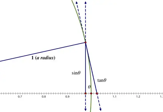

Typically, this is used with the squeeze theorem to prove that $\lim_{\theta\to0}\frac{\sin\theta}{\theta}=1$, so assuming you want your inequality to hold for $\theta$ near (but not equal to) $0$, consider the following picture, showing part of a unit circle for small $\theta>0$.
diagram
The length of the small (green) circular arc is $\theta$ and $\sin\theta<\theta$ since the perpendicular distance from the point on the circle to the $x$-axis is the shortest distance from that point to the axis, so $\frac{\sin\theta}{\theta}<1$. Similarly, $\theta<\tan\theta$ which is equivalent to $\theta\cos\theta<\sin\theta$ or $\cos\theta<\frac{\sin\theta}{\theta}$.

  • Not entirely sure why it is safe to conclude from the diagram that $\theta < \tan \theta$. Can you add a line arguing that? – Ben Blum-Smith Feb 21 '12 at 16:08
