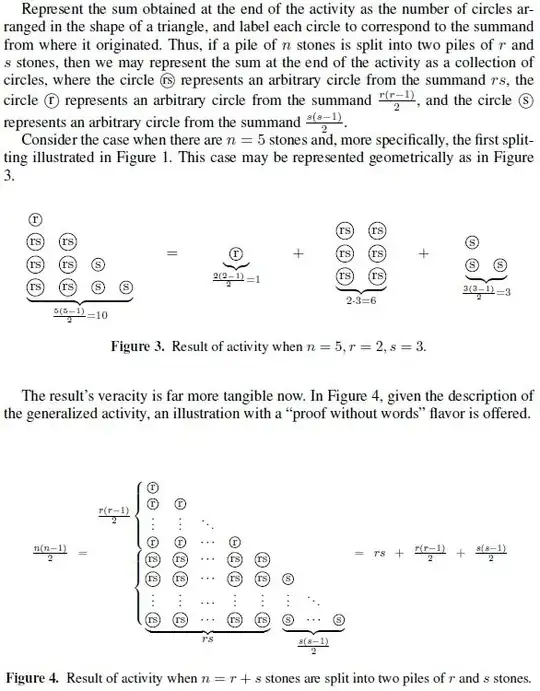

Here is something I cobbled together that others may wish to see: enter image description here
Any better (i.e., intuitive, etc) ways of doing it though?
