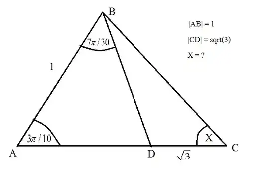

From this geometry problem, I can not find geometry solution. However the answer is $X=\frac{2\pi}{15}$ by geometry method. enter image description here
Then I get the identity $$\left(\sqrt{3}\sec{\frac{\pi}{5}}+\tan{\frac{\pi}{30}}\right)\tan{\frac{2\pi}{15}}=1.$$
How to prove it by trigonometric method ?
