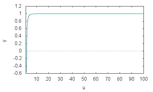

Thus $F(x) = 1-\frac{Ce^{\Re(\Gamma(0,-\ln(u)))}}{\ln(u)}$. If we set $C=1$, this function is a valid distribution function for a random variable defined on $[1.72719,\infty)$. Its plot is shown below:
Note: This is no
Note that it crosses the $x-$axis at $x\approx 1.72719$, so the random variable's distribution function would be $P(X<x)= \mathbf{1}_{>1.72719}(x)F(x)$
Unfortunately, $P(X>x)=1-\mathbf{1}_{>1.72719}(x)F(x)$ shrinks faster than an exponential, hence it will not satisfy $(i)$. Thus, $(ii) \nRightarrow (i)$
