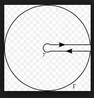

$\newcommand{\angles}[1]{\left\langle\, #1 \,\right\rangle} \newcommand{\braces}[1]{\left\lbrace\, #1 \,\right\rbrace} \newcommand{\bracks}[1]{\left\lbrack\, #1 \,\right\rbrack} \newcommand{\ceil}[1]{\,\left\lceil\, #1 \,\right\rceil\,} \newcommand{\dd}{{\rm d}} \newcommand{\ds}[1]{\displaystyle{#1}} \newcommand{\dsc}[1]{\displaystyle{\color{red}{#1}}} \newcommand{\expo}[1]{\,{\rm e}^{#1}\,} \newcommand{\fermi}{\,{\rm f}} \newcommand{\floor}[1]{\,\left\lfloor #1 \right\rfloor\,} \newcommand{\half}{{1 \over 2}} \newcommand{\ic}{{\rm i}} \newcommand{\iff}{\Longleftrightarrow} \newcommand{\imp}{\Longrightarrow} \newcommand{\Li}[1]{\,{\rm Li}_{#1}} \newcommand{\norm}[1]{\left\vert\left\vert\, #1\,\right\vert\right\vert} \newcommand{\pars}[1]{\left(\, #1 \,\right)} \newcommand{\partiald}[3][]{\frac{\partial^{#1} #2}{\partial #3^{#1}}} \newcommand{\pp}{{\cal P}} \newcommand{\root}[2][]{\,\sqrt[#1]{\vphantom{\large A}\,#2\,}\,} \newcommand{\sech}{\,{\rm sech}} \newcommand{\sgn}{\,{\rm sgn}} \newcommand{\totald}[3][]{\frac{{\rm d}^{#1} #2}{{\rm d} #3^{#1}}} \newcommand{\ul}[1]{\underline{#1}} \newcommand{\verts}[1]{\left\vert\, #1 \,\right\vert}$ \begin{align}&\color{#66f}{\large% \int_{-\infty}^{\infty}{1 \over \cosh\pars{x}}\,\expo{2\pi\ic tx}\,\dd x} =2\overbrace{\int_{-\infty}^{\infty} {\pars{\expo{x}}^{2\pi\,\ic\,t} \over \pars{\expo{x}}^{2} + 1} \pars{\expo{x}\,\dd x}}^{\ds{\dsc{\expo{x}}\ \mapsto\ \dsc{x}}} =\dsc{2\int_{0}^{\infty}{x^{2\pi\,\ic\,t} \over x^{2} + 1}\,\dd x} \\[5mm]&=2\bracks{2\pi\ic\,{\pars{\expo{\ic\pi/2}}^{2\pi\,\ic\,t} \over 2\ic} +2\pi\ic\,{\pars{\expo{3\ic\pi/2}}^{2\pi\,\ic\,t} \over -2\ic} -\int_{\infty}^{0}{x^{2\pi\,\ic\,t}\pars{\expo{2\pi\ic}}^{2\pi\,\ic\,t} \over x^{2} + 1}\,\dd x} \\[5mm]&=2\pi\expo{-\pi^{2}\,t} - 2\pi\expo{-3\pi^{2}\,t} +\expo{-4\pi^{2}\,t}\ \dsc{2\int^{\infty}_{0}{x^{2\pi\,\ic\,t} \over x^{2} + 1}\,\dd x} \end{align} where we used a 'key-hole contour' as depicted in the following picture:
enter image description here'
Integrand poles are at $\dsc{\expo{\ic\pi/2} = \ic}$ and $\dsc{\expo{3\ic\pi/2} = -\ic}$ according to the $\ds{x^{2\pi\ic t}\,}$-branch cut.
Then,
\begin{align}&\color{#66f}{\large% \int_{-\infty}^{\infty}{1 \over \cosh\pars{x}}\,\expo{2\pi\ic tx}\,\dd x} =\dsc{2\int^{\infty}_{0}{x^{2\pi\,\ic\,t}\over x^{2} + 1}\,\dd x} =2\pi\,{\expo{-\pi^{2}\,t} - \expo{-3\pi^{2}\,t} \over 1 - \expo{-4\pi^{2}\,t}} \\[5mm]&=2\pi\,{\expo{\pi^{2}\,t} - \expo{-\pi^{2}\,t} \over \expo{\pi^{2}\,t} - \expo{-2\pi^{2}\,t}} =2\pi\,{\sinh\pars{\pi^{2}\,t} \over \sinh\pars{2\pi^{2}\,t}} ={\pi \over \cosh\pars{\pi^{2}\,t}} =\color{#66f}{\large\pi\sech\pars{\pi^{2} t}}\,,\qquad t \in {\mathbb R} \end{align}

    It took a while to see what you were using a keyhole contour to evaluate the integral in red (similar to this answer). It might be nice to mention the contours used and the residues computed. – robjohn Jan 07 '15 at 18:42
    In general lines, more words are usually welcome! – Pedro Jan 08 '15 at 06:46
  • @robjohn I just added a picture. I'm quite bad for drawing. So, I have to borrow them from the Web. We do those calculations so many times that we expect everybody get the whole idea right away. Thanks for pointing out the missing contour. – Felix Marin Jan 08 '15 at 06:48
